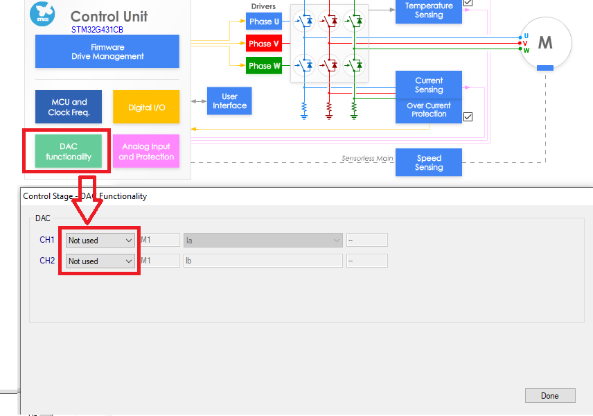

2021-02-09 7:09 AM
Hi @BTrem.1 ,
Have you already tried to disable the DAC in the MCSDK project ?
Select the "DAC Functionality" block and select "Not Used" for both DAC channels.
Then generate the .ioc and proceed as you already have described.
In the C source code you can add the configuration of the DAC as you need.
I hope this can help you !
