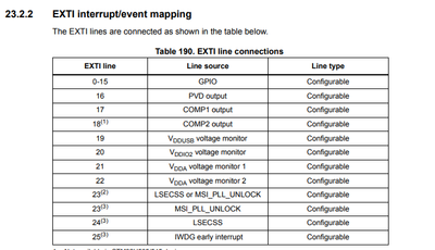

Hi, this is the part I'm struggling with currently. The comments say
/* Enable EXTI Line 18 for USB wakeup */
__HAL_USB_WAKEUP_EXTI_ENABLE_IT();
HAL_NVIC_SetPriority(USBWakeUp_IRQn, 0, 0);
HAL_NVIC_EnableIRQ(USBWakeUp_IRQn);
but I'm not sure that the stm32u5g9 has that same configuration as well
or rather, I don't know how to read this
STM32U5 series Arm<Sup>®</Sup>-based 32-bit MCUs - Reference manual
I've attached the reference manual for use
2025-08-20 6:07 AM
Are there U5 examples you could start from instead? Yes, quite a few things will be different between those two chips.
