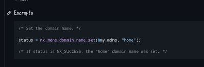

I am using Azure RTOS with NetxDuo, I implemented a secure https server in my device and implemented mDNS which was working very well for me till I required to change domain. I want to add a sub-domain like (myhostname.mysubdomain.local). In documentation it is stated that by default the domain is .local but can be changed using following API

status = nx_mdns_domain_name_set(&mdns_instance, "home");
status = nx_mdns_enable(&mdns_instance, PRIMARY_INTERFACE);
It returns success and according to the document I must be able to ping hostname.home but thats not the case not matter what I done it will be always accessible through hostname.local

2024-07-22 10:51 AM
@STea Unfortunately no, https://github.com/eclipse-threadx/rtos-docs/blob/main/rtos-docs/netx-duo/netx-duo-mdns/chapter4.md
In this example they have used only domain in this api, and this is the only document and example I could find.
