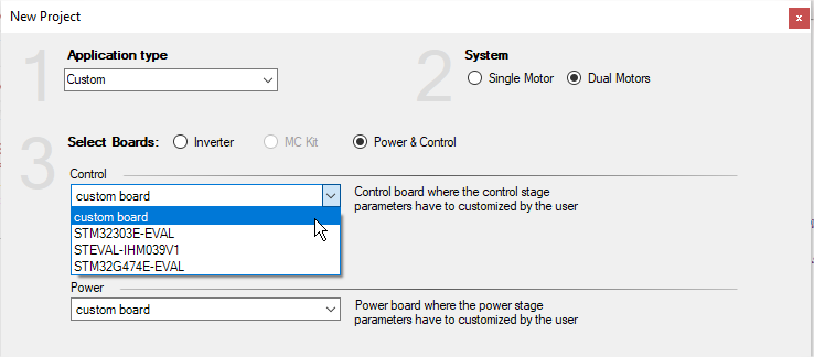

2022-09-07 8:36 AM
Using WB5.4.8 e.g., you can choose Dual Motor configuration. You will have a set of available control boards for that purpose:
Generating the code, the dual motor api will be visible in mc_api.c.
3 motors are not supported by the workbench for the moment.
Best regards.
GMA
