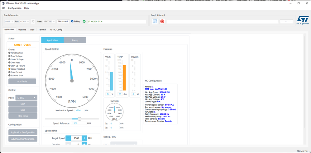

2) When I try to generate code using Motor Control Workbench (5.Y), I generate code using CubeMX (6.3) and flash it using CubeIDE (1.10.1) -->I run motor using Motor Pilot but it always says "Speed Feedback Error". I don't know why this happens.

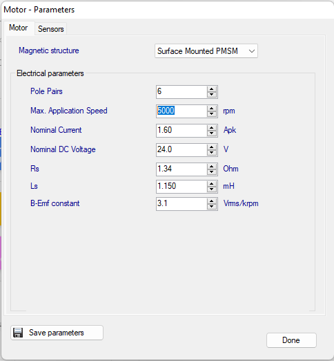

I updated the motor parameters as per the motor's datasheet. Both in the motor workbench as well as checked the appropriate header files. All the information and specs are correctly loaded in the IDE.
Here is the motor description: https://lin-docs.s3.us-west-2.amazonaws.com/datasheets/external/bldc/BL17E19-01D-03RO.pdf

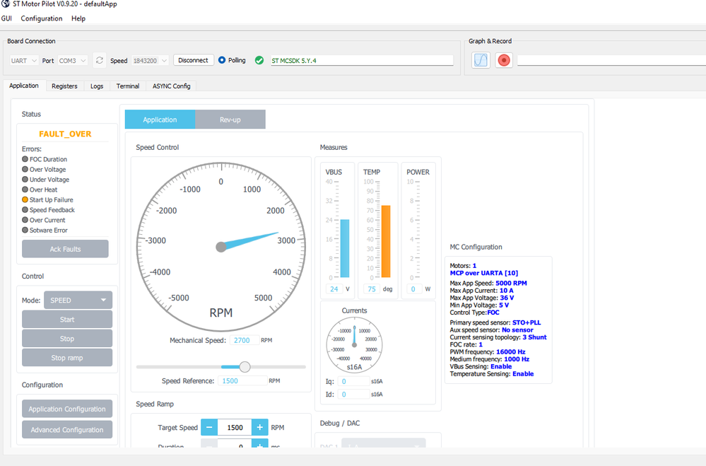

However, the error I get is startup failure. The code flashes correctly in the MCU but the motor just hums and runs for almost 1-2 seconds, and stops and shows failure. Even when I modify the code to run it using the MC_StartMotor1(); command.

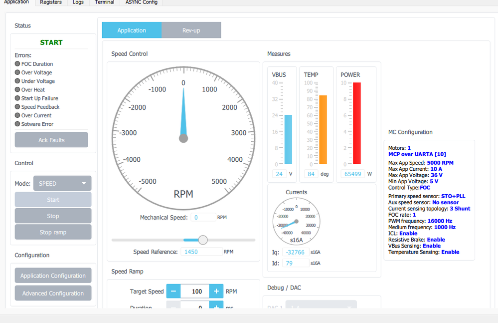

Here is an update:
Whenever I run the motor using the motor profiler tool, the following happens.
You can see the power measure is off the chart up to 65kW. I don't think that should be correct. But I don't understand why this happens.
Regards
Anirudh

A short remark, it is mentioned in Motor specification document "Pole Number 6", I assume that it means 3 Pole Pairs...
In Motor Setting WorkBench, "Pole Pairs" is set to 6.
Did you try with 3?
Best regards.
GMA
2022-08-22 7:40 AM
Hello, I tried using 3 pole pairs, and I get the same error - Startup failure. I think I did that before as well because I was confused about the specs too but I did it again and it throws the same error.
Regards
Anirudh
Edit: The only difference is that when I select 3 pole pairs, it seems to spin more aggressively as it starts but then again the humming and full stop. Startup failure.
However, thank you for pointing that out. I did check the pole pairs manually, by shorting the two phases and I could feel 18 bumps/clicks.
18 --> 3 phases = 6 poles = 3 pole pairs.
My understanding is correct, right?
