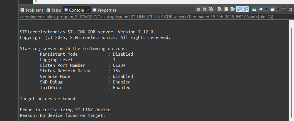

Unable to run the program in the MCU. When I try to execute the program in my Nucleof401re board, The IDE says it is not able to detect the board. I'm literally struck here just to blink an led. I kindly appreciate any possible solutions. But do explain it in simple terms as I'm new to this kind of stuffs.

Can you connect with STM32CubeProgrammer?
Ensure the USB cable is not power-only. The LED will be solid red when the USB connects. If it's blinking between red and off, there is no connection.

Hello @Karthi_electro and welcome to STcommunity
Can you please check if these steps are established:
You can check section 6.1 from the STM32 Nucleo-64 boards (MB1136) - User manual
