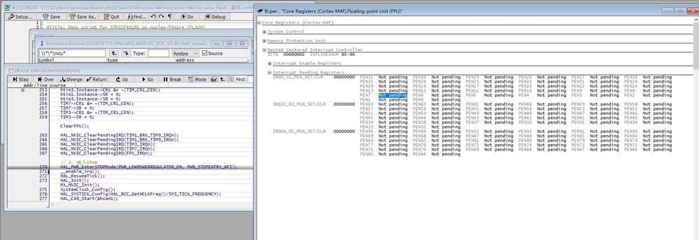

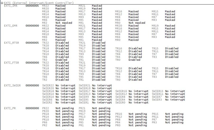

Before calling below code, I checked, no pending interrupt, also for EXTI.
HAL_PWR_EnterSTOPMode(PWR_LOWPOWERREGULATOR_ON, PWR_STOPENTRY_WFI);And I had tried if I do not call the MX_MotorControl_Init(line30) in main, the sleep and wakeup both work, anyone can provide some suggestions?
