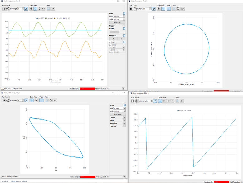

I'm driving a PMSM with FOC (Workbench file attached for reference) with MCSDK 6.3.0 in torque mode.
Main parameters:
With the default settings of OCP -- 45 Apk and 47.06 ns filter -- OCP is reliably triggered when Iq reference goes above about 7.5 A. To get to 20 A I have to seriously increase both the filter duration and the threshold, which feels a bit unsafe...
Measured Iq and Id plots have very noticeable first-order oscillations, but everything else seems to be reasonably normal, and the torque response (and the speed control as well) is good:
The magnitude of Iq and Id's oscillations can be somewhat reduced by a more agressive PID tune (essentially increasing the cut-off frequency of the current loop) but this eventually causes to loop to become unstable (as expected).

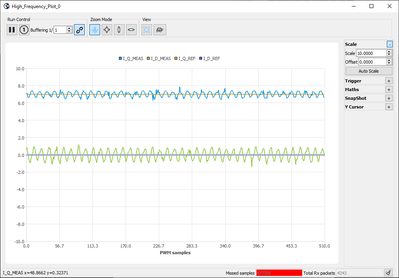

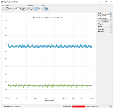

Following up on this -- it was a faulty motor with internal short circuits.
Some noise on Iq/Id is expected, but the amplitude of it shouldn't be strongly related to the value of reference Iq/Id as was the case here. E. g. what I learned in relation to this motor is that you shouldn't get ±5A noise on 10A Iqref and ±10A noise on 20A Iqref.
Here's the same plot with a non-fauty motor (7A torque setpoint):

For the short current peaks, you can check with a scope the comparator input signals that are available on the board at TP4, TP5 and TP6 test points.
On your display, Iq/Id harmonic seems to be 2 times the motor frequency. Motor cogging torque could be a root cause this behavior.
...and with 50A torque setpoint:
