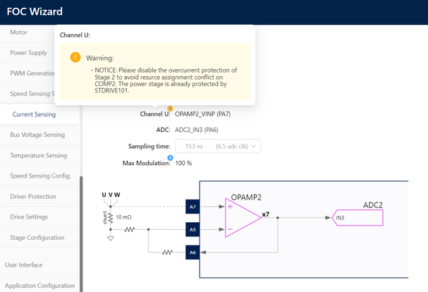

I continuously see the following warning:
NOTICE: Please disable the overcurrent protection of Stage 2 to avoid resource assignment conflict on COMP2. The power stage is already protected by STDRIVE101.
I have already disabled the Overcurrent Protection in Stage 2, however the warning still appears.

2026-01-16 2:15 AM
Hello @pelino,
This is a warning message to avoid resource assignment conflicts on COMP2 and, as you mention, is independent of OCP usage.
It does not prevent project generation.

Hello @pelino,
This message is a default warning, not an error. The message appears regardless of the configuration.

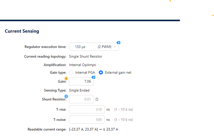

So, if Overcurrent Protection was triggered, does that mean the current exceeded 23.5 A?

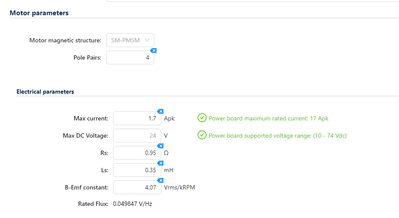

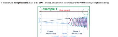

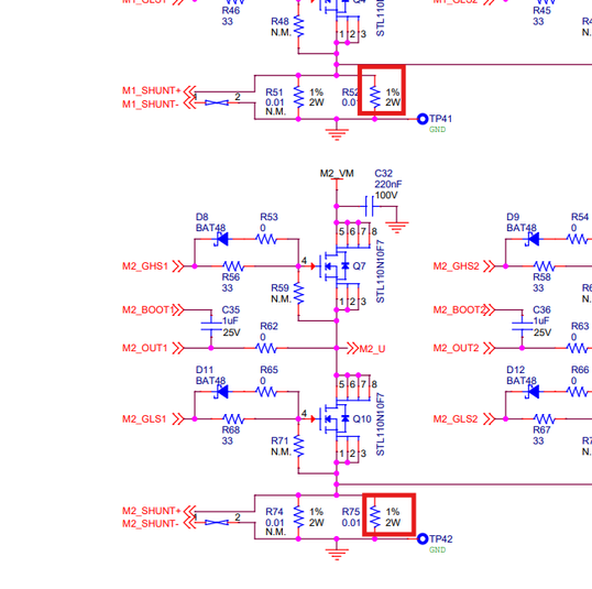

Regarding the Overcurrent Protection,
if the current exceeds the maximum current value of 1.7 A, will the protection be triggered?
Also, was the current waveform shown below measured using a shunt resistor?
Is there a way to measure or monitor the current using Motor Pilot instead?
Thank you for your support.

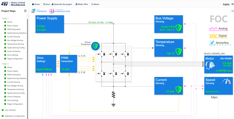

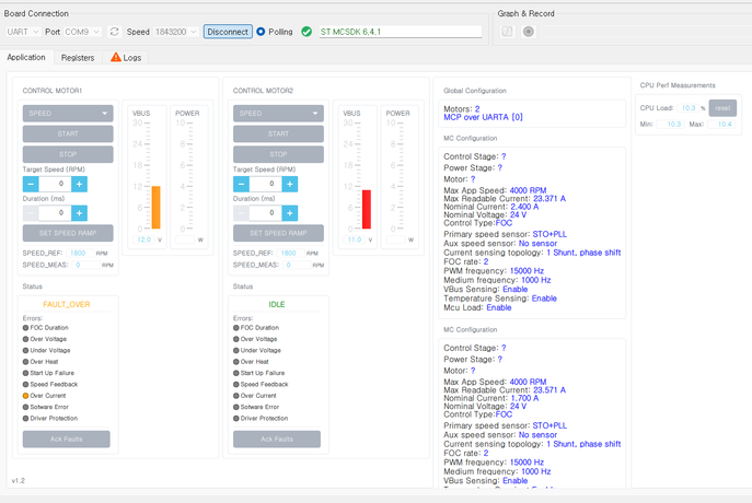

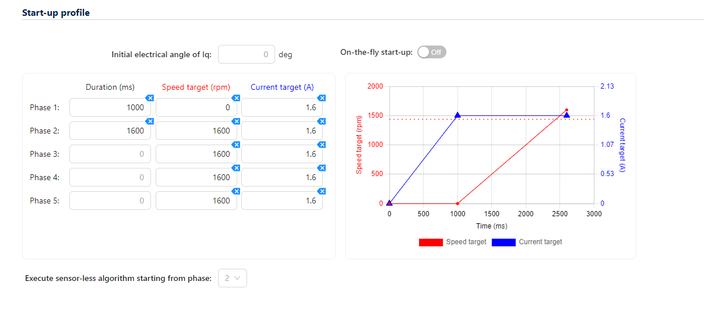

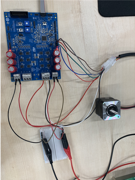

I created an EVSPIN32G4-DUAL project using MK Workbench.
I am currently testing with only one motor connected to the EVSPIN32G4-DUAL.
As shown below, an Overcurrent Fault occurs on Motor 1.

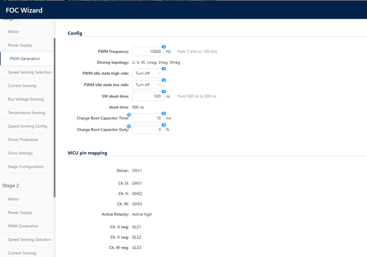

Even after changing the environment settings as shown below, the Overcurrent error still occurs.
1. Check of the current sensing topology
2. Change the PWM frequency
3. Change the start-up profile
4.Modify the sensorless start-up parameters
