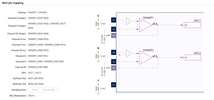

I'm struggling with frequent overcurrent faults at the EVSPIN32G4 board.
I found some mismatch of current sensing with 3-shunt and 2-OPAMP topology.
Default current sensing for EVSPIN32G4 is described as following diagram at motor control workbench.

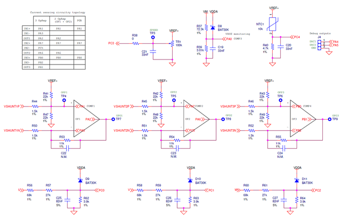

But, the EVSPIN32G4 schematic drawing is as follows.
It is a mismatch of the MC workbench and the schematic of EVSPIN32G4
[MC workbench : W Phase] OPAMP2 (+) : PB0, OPAMP2 (-) : PC5, OPAMP2 (out) : PA6
[Schematic: V Phase] OPAMP2 (+) : PA7, OPAMP2 (-) : PC5, OPAMP2 (out) : PA6
I'm wondering about this mismatch and it might be the cause of overcurrent fault.
Thanks for any advice in advance.

Thanks for the quick response.
As you mentioned it at the MC workbench diagram,
W phase is connected with OPAMP2 pins through GPIOs as follows : PB0(IN+), PC5(IN-), and PA6(OUT).
But, as according to following table from the EVSPIN32G4 schematic,
OPAMP2 pins are connected with GPIOs : PA2(IN+), PA7(IN-) and PA6(OUT) .
I would like to know this H/W current sensing topology be matched with the automatic generated codes by the MC workbench.

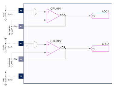

Hello @rokkie,
Using MCSDK6.3.2, I have a correct description on current sensing:
Are you using a modified board description?
2025-05-16 2:37 AM
No. I am using the original EVSPIN32G4 board.
As I mentioned it, the current sensing is a little different between MC workbench and EVSPIN32G4 schematic.
2025-05-16 5:09 AM
Hello @rokkie,
Maybe I did not catch your point.
In workbench schematic you can notice that V Phase is a Shared Phase between OPAMP1+ and OPAMP2+ (thanks to OpAmp + input mux). Then OPAMP2 (+) input could be PB0 or PA7.
