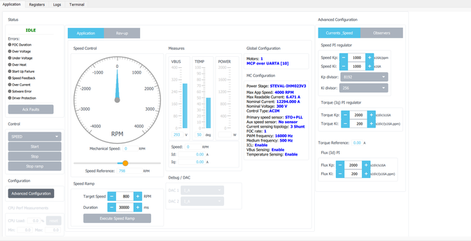

Based on my understanding of FOC loop theory, I estimated the KP and Ki values for the speed and current controllers. However, during testing with Motor Pilot, it seems the values have specific units, and I'm unsure how to adapt my values to them (see attached image).

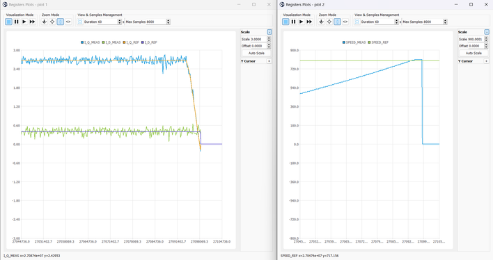

Using the tachometer, I compared the real speed with the observed speed and found a difference of around 50 RPM during acceleration but the main issue is that when the observed speed reach the target speed, iq is reduced (as part of the control loop) to regulate the speed, however even when the real speed of the rotor is reduced (measured with the tachometer) the observer does not register this change and think the speed is still high therefore keeps reducing iq ref until the motor stop but the observer is still obtaining a wrong speed and then the control loop gets out of control.(See images)
I think that i have a problem with the observer Kp/Ki and/or K gain, but i have tried different values but i was not able to fix it. I would greatly appreciate any suggestions to help me troubleshoot this issue.

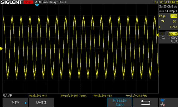

Additionally, I tuned the current controller, and the waveform I obtained is as follows:
Does this look good to you? Let me know if you need any more changes!
2024-09-04 8:52 AM
Hello carlos_gtronix.
From the screenshot it seems the current waveform is smooth without any jitter/noise; you may even try to increase the Kp/Ki of the current controllers (same values for Iq/Id for instance). Anyway, that is not your main concern for the time being. Are you using a custom motor prototype, is the datasheet available somewhere on the net?
