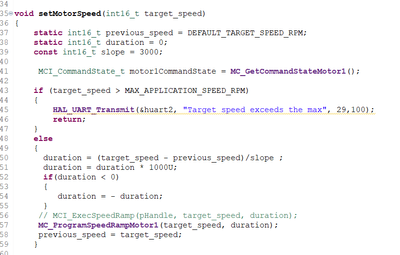

This is the code i am using to generate the ramp in six step algorithm, The MC_ProgramSpeedRampMotor1 api is created in six steps to modify the ramp; however, ramp changes cannot be made with this api. Could you please assist me? Is there another method to modify the ramp in a six-step algorithm?

Are you sure that the effect of your code is not an overcurrent event?

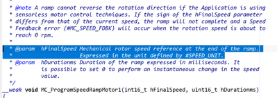

I see an error in the usage of the speed. As indicated in the documentation the api accepts the speed expressed in #SPEED_UNIT.
So, I suggest to use the macro RPM_2_SPEED_UNIT(rpm) to convert it before calling the function.
MC_ProgramSpeedRampMotor1(RPM_2_SPEED_UNIT(target_speed), duration);
