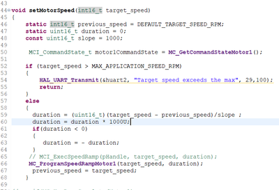

void MC_ProgramSpeedRampMotor1(int16_t hFinalSpeed, uint16_t hDurationms)
The ramp is with respect to the time that is you may want to achieve the speed in 5seconds, 10 seconds etc. To change the speed you have to update the hFinalSpeed, provide different values as arguments to the function MC_ProgramSpeedRampMotor1 for example 100, 200 RPM (verify the units the function MC_ProgramSpeedRampMotor1 expects). Can you show how you are passing parameters to the MC_ProgramSpeedRampMotor1 function?

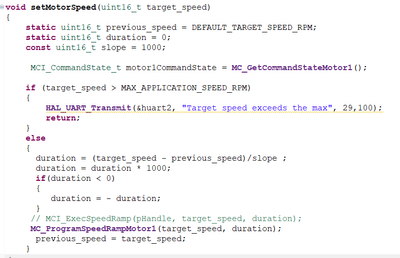

2023-12-14 4:50 AM
2023-12-14 6:18 AM
I find mistakes duration is unsigned but you are checking for less than 0
The targetspeed is a signed value but you are passing unsigned value. Please check those coding errors.
2023-12-14 9:32 PM
I have changed to signed but still the ramp is not reflecting in the motor
