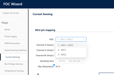

We would like to use MC workbench, however we want to move from ADC1/2 to ADC12 for the current sense, VBUS and temperature NTC. Is there a way to implement this alternate ADC configuration in MC workbench? If we need to manually change the FW, is there anything we need to watch out for?

Hello @Hattie,
The workbench provides the ability to choose from all available ADC configurations.
