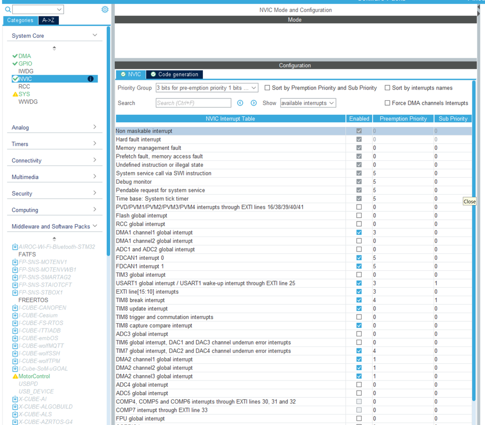

I have tried moving the MC tasks from systick into a custom timer (tim7 in the example below) and using systick for RTX5 OS. This works to a degree (motor spins, no faults), but it is clear something is interfering with the FOC/HSO algorithm as the motor emits oscillatory noises, indicating regulation is not working as it should.

It sounds like a timing/priority issue rather than a functional failure, especially since the motor still spins without faults. FOC control loops are extremely sensitive to interrupt latency and jitter, so moving MC tasks away from SysTick can easily introduce instability if RTX5 scheduling or interrupt priorities interfere with DMA/ADC timing.
You may want to verify that all motor-control interrupts remain at higher priority than the RTOS kernel interrupts and avoid any blocking RTOS calls near the control loop. Unfortunately, ST doesn’t provide many official RTOS + MCSDK reference projects, but several users report better results by keeping the fast FOC path entirely outside the RTOS and only using RTX tasks for UI/communication logic.
