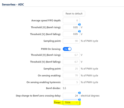

3. To avoid the conflict between MCU resources, select a different timer for the speed controller in the workbench (tab "Speed sensing config", for instance TIM4)

I tried to replicate your set-up with the G431-ESC. I used a BullRunning BR2804 motor (the one pre-defined in the workbench) that looked similar to yours (rated voltage 12V, 7pole pairs, high rated speed, low voltage constant)
1. At first I ran it at 16kHz. Improving the speed loop gain, reducing the bemf thresholds and the demagnetization time at the beginning of each step ("minimum demag time" in the "Drive settings" section), I easily reached 4.5krpm. Beyond this speed, the motor starts to hiccup until overcurrent occurs. As said in my previous post, at this speed there are very few points to discriminate the bemf zero crossing (4-5 points, one each pwm cycle) and the desyncronization of the rotor is unavoidable
2. Then I increased the frequency to 50kHz, reduced the 6step loop execution time (to limit the number of interrupts and the MCU load), tuned the startup parameters and the delay between the zero crossing and the step changed. I reached over 12krpm.
I attached the screenshots and the wbmx6 files I used to generate the code, hoping that they are of any help.

Thanks, I was able to get the motor working at nearly desired RPM using the combination of things you mention.

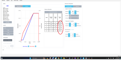

2. The circled are in the picture above has strange values which I don't udnerstnad the meaning of. . Where can I get most up to date documentaiton on all of these parameters? (I find the format of the PID controller values very confusing)
