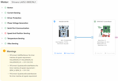

prathmeshpatil06
Associate
please, look i added screenshot. I am getting different errors.
Hello @prathmeshpatil06,
Did you modify the NUCLEO-G431RB.json description file?
Refer to the supported hardware topologies in the STM32G4 structure of the ConnectionParameters.json file located in the MC_SDK_x.x.x\Utilities\PC_Software\STMCWB\assets directory.
If you agree with the answer, please accept it by clicking on 'Accept as solution'.
Best regards.
