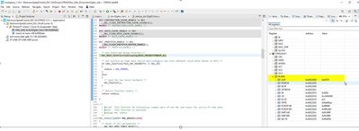

Could you please check that via IDE you have access to FLASH registers as below?
