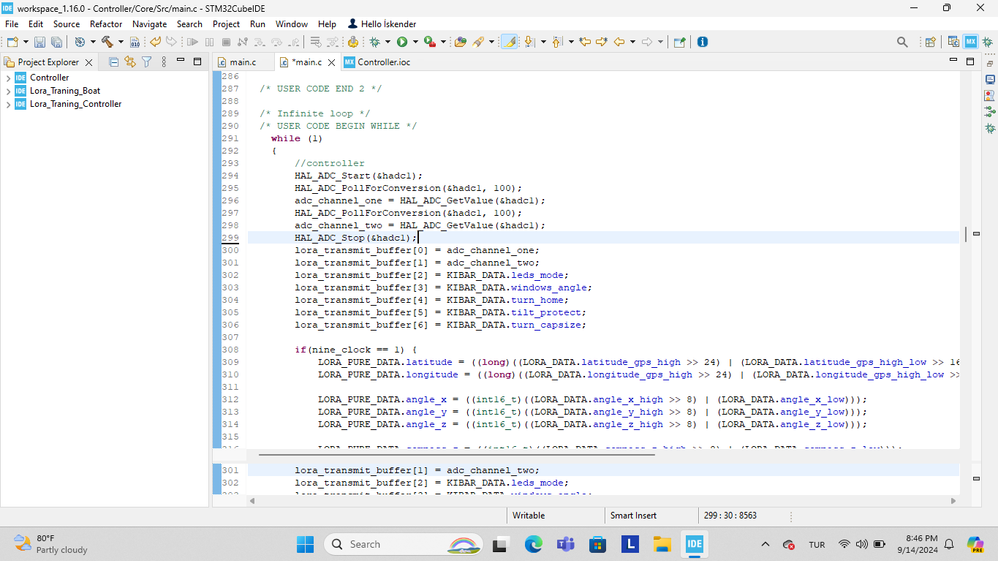

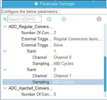

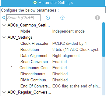

I am using the STM32F413ZH model. In fact, there is no problem in the code I wrote below, everything works correctly, but if I call the HAL_ADC_START function outside the while and do not use the HAL_ADC_STOP command, this time it only makes one reading, what is the reason for this? In this case, he has to read continuously, doesn't he?
Thank You.
2025-01-31 2:14 AM
Hello @AlexanderKibarov,
You can find in the reference manual of the STM32F413ZH microcontroller [Link: here]: information about ADC conversion modes (Single Conversion and Continuous Conversion).
Additionally, the two examples available in STM32CubeF4, namely ADC_RegularConversion_DMA and ADC_RegularConversion_Interrupt, can guide you for the correct implementation.
