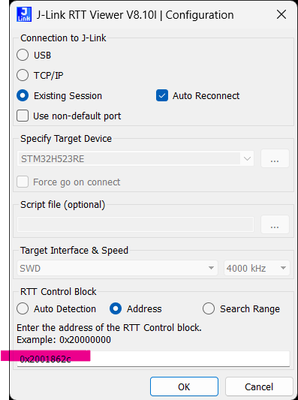

when I increase the size of the ThreadX trace buffer above 30k the RTT output is not working anymore (Below 30k RTT works fine).
static uint8_t trace_buffer[1024*64] __attribute__((section(".trace")));
My guess is that the RTT viewer can't find the RTT control block anymore. I can't explain myself why this is the case.
When checking the map file I find the control block near the end of SRAM1, which should not be a problem I think?
Anyone some idea, how to fix the RTT output? Any help is appreciated :)

After setting the address of the control block in the RTT viewer the output works again.
