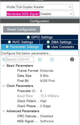

2024-08-30 2:22 AM
Did you keep your SPI_polarity HIGH, SPI phase is 2nd edge. Then configure the GPIO connected to the CS pin of the device to GPIO output and make it low while reading . Please share the ioc file
2024-08-30 2:40 AM
I think the setup is done.
Thank you in advance for your cooperation.

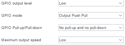

2024-08-30 2:58 AM
select GPIO output level as high since the default for CS is high, the chip is not selected normally, selected only when you do the read
