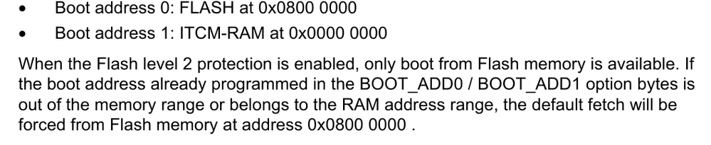

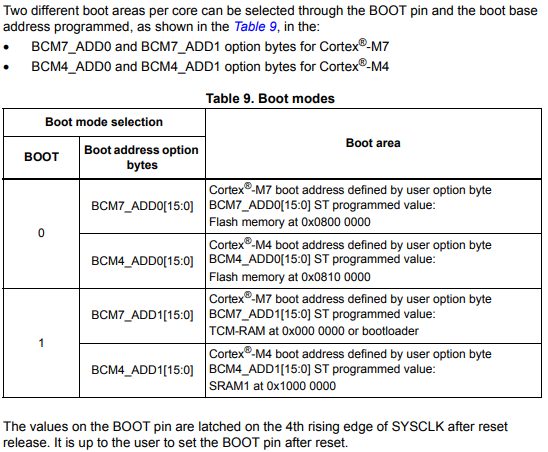

from rm:
Moktar
Hello @MA4
In RDP level 2, on boot for user flash is allowed so booting from System memory and RAM is disabled.
The Boot pin feature enables the selection of 2 boot areas :
1- you are using RDP level 2, setting BOOT_PIN = 1 is no more possible  ( CM7 boots to TCM-RAM or system bootloader and CM4 boots to SRAM1)  only BOOT_PIN = 0 is possible (boot to user flash  ).
2- When changing the default starting boot address in linker script, you should have also to update the option bytes (BCM7_ADD0 and BCM7_ADD0 ) with the new addresses, or you can setup in the linker script with the default boot address that is already set for both cores.
3- Even though, you set BOOT_ADD1 in the option bytes ( this points to RAM), in RDP level 2 this is considered invalid and the system will forcefully boot to the default address which is ADD0.
Please check RM0399 section 2.6 Boot Configuration for more information.
