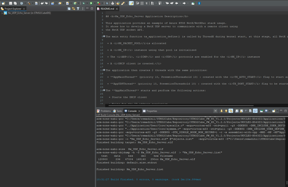

Hello @SiSte ,
can you try to open the project from C:\Users\your_name\STM32Cube\Repository\STM32CubeH5\Projects\NUCLEO-H563ZI\Applications\NetXDuo\Nx_SNTP_Client\
and compile it as i Don't seem ti get the same issue as you are describing even with version v1.3 of CubeFW
Try to not import it from project selector in MX and tell me if you are able to compile.
Regards

Hello @SiSte ,
can you share with us the version of STM32H5Cube FW from which you extracted these examples?
as I have the Netxduo projects all compiling without errors on warning using IDE v1.16 and STM32H5Cube FW v1.2
If you got this FW from Github make sure to use
git clone --recurcive https://github.com/STMicroelectronics/STM32CubeH5.git
Regards

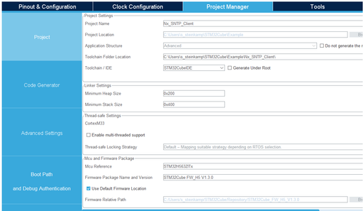

Hi and thanks for your reply,
I also run the IDE v1.16. I assume, that my FW Version is v1.3.0, as this is shown in the Cube Project Manager tab:
I did not clone the example code on my own, as far as I recall, CubeMX downloaded it.

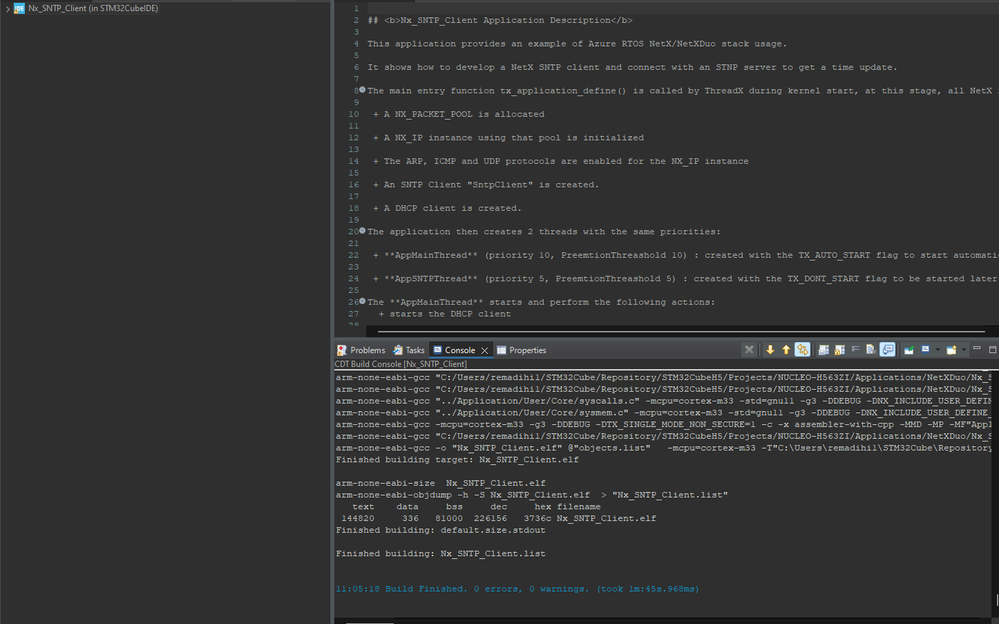

Hello @SiSte ,
Regards

Hi STea,
apparently, this was at least part of the solution. What I did was cloning the H5Cube repo (recusively), create an empty project in the IDE and copy the files into it. Then the example builds as expected. As you assumed, the issue came with selecting the project example in MX and creating a project from it.
My issue is solved, thanks a lot.
