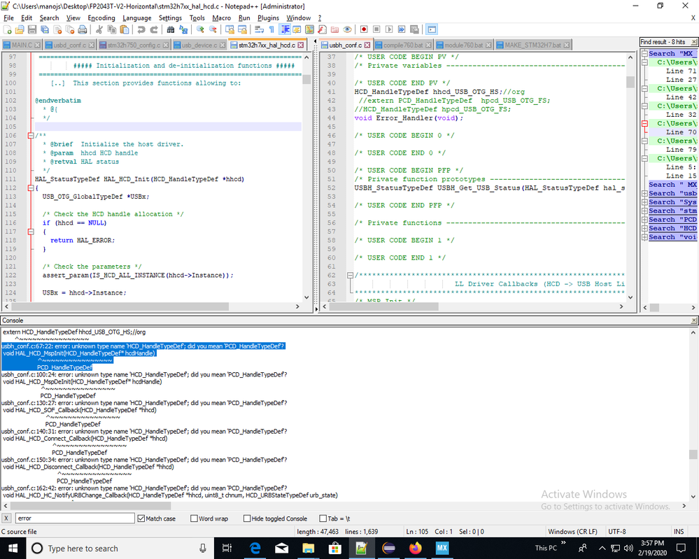

Please solve the error , i am using USB HOST in my Project but my code is already developed without USB HOST So i am implemented USB HOST in my project

Sorry your post does not give information on your context : board, chip, application etc ...
I guess from screenshot you are working on STM32H7 ..

HCD_HandleTypeDef is defined in [CubeH7]\Drivers\STM32H7xx_HAL_Driver\Inc\stm32h7xx_hal_hcd.h
