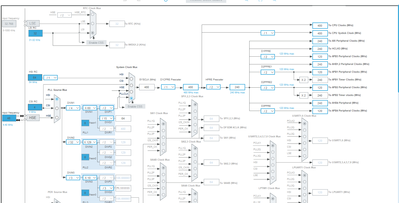

2026-02-09 6:12 AM
Thank you very much for this explanation — this was a detail I was completely unaware of, so I really appreciate you pointing it out.
I checked the ST-Link configuration on both boards and confirmed that they are both ST-Link V3 and configured to use HSI/2 = 8 MHz as the MCO output. Unfortunately, this did not change the observed behavior.
To further investigate, I also tested with a third NUCLEO-H743ZI2 board, and the situation became even more confusing. While the second board was at least relatively consistent (around ~1990 SOF events per second), the third board shows highly unstable behavior, with SOF counts fluctuating continuously between ~1000 and ~1900.
I will revisit the points you mentioned in more detail and try to analyze the clocking and USB timing behavior more carefully. If I manage to identify the root cause, I will update this thread with my findings.
Thanks again for taking the time to respond and for the very useful information.
2026-02-09 6:19 AM
In doubt it might be better to solder a crystal on the board and the set the solder bridges to use it instead of ST-Link supplied MCO?

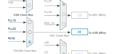

2026-02-09 7:00 AM
Thanks for the clarification. To be honest, I was not fully confident about my clock configuration. I could not find a straightforward way to derive a clean and exact 48 MHz USB clock from the PLL with my current setup, so I chose to use RC48 instead. From a functional point of view, USB communication has been working without any visible issues.
However, after looking more carefully into the points you highlighted, I now believe that the main source of the observed behavior is very likely related to using RC48 as the USB clock source (jitter, clock domain separation, and interrupt latency effects), rather than a firmware or board defect.
Thanks again for pointing this out — it helped me better understand what I’m seeing.
