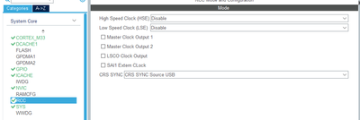

Enable the [CRS SYNC SOURCE USB] option in CRS SYNC, located in the [RCC] section.

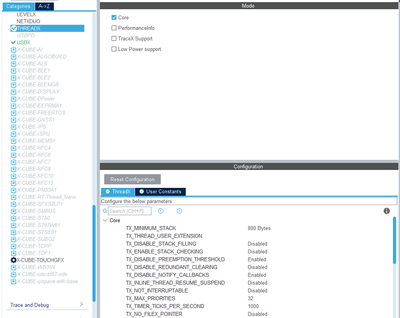

Enable the [CORE] in THREADX, located in the [Middleware and software packages] section.

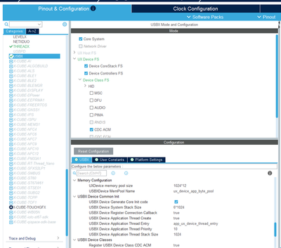

Increment the [TX_MINIMUM_STACK] to 800 bytes.
Enable the [Core system] [Device CoreStack FS] [Device Controllers FS] [CDC ACM] in USBX, located in the [Middleware and software packages] section.
Change [UXDevice memory pool size] to 12*1024.
Change [USBX Device system Stack size] to 6*1024.

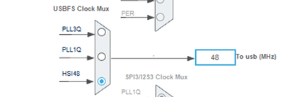

In the [CLOCK CONFIGURATION], just ensure that the USB is getting a 48MHZ signal.

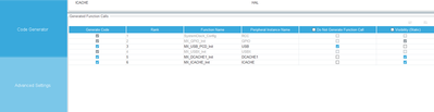

In the project manager, select advanced settings and fill the options like this.
Now, name your project and generate your code.
