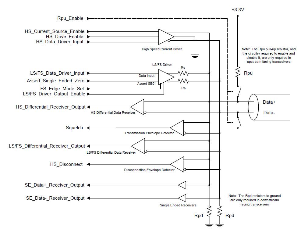

I can't switch to another product, since I am far to deep in the design process. I must say that I am pretty disappointed from STM for not making it clear enough in the features list of the STM32F303xx that I need additional components for using the USB-feature properly on the STM32F303xx . As far as I have overlooked theSTF202-22T1G the Chip doesn't have the possibility to switch the PullUp on or off. But isn't this mandatory in complinace with the USB 2.0 spec (see attached image)?
If this chip is enough for my purposes (DFU, CDC, HID) then I will go for it. Spares me also the EMI, ESD chip from TI.
best regards
Benjamin

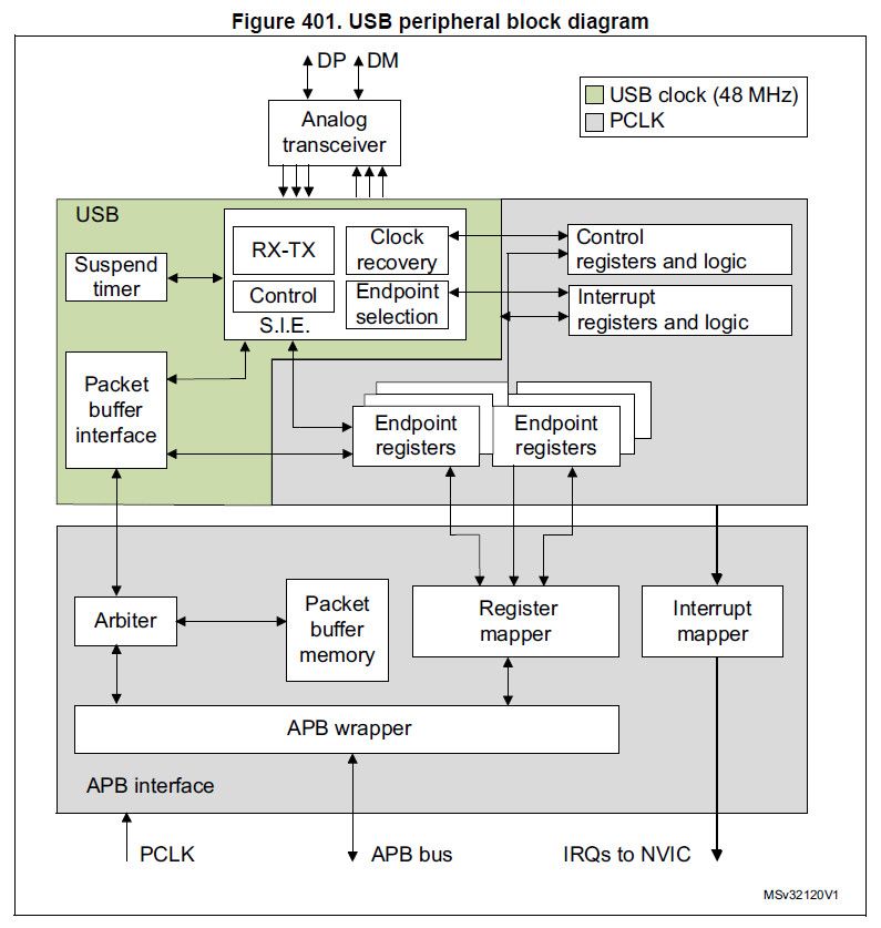

Mhh.. I am also not sure if I need another USB PHY chip, since the block diagram of the STM32F303xx shows an external Analog transceiver:
What Do you think?
2017-03-19 9:12 AM
Haven't looked at the ref man for this part. On stm32f437 there are 2 usb ips to be accurate: a full speed with embedded analog transceiver and a high speed external flavour which uses ulpi digital interface witg external chipset. Both can be activated in parallel and there was a dual usb core example. In somer newer part such as stm32f723, the 600+ mbps class phy is embedded. So far as i know.
2017-03-19 10:41 AM
Mhh..this sounds like I have to supply the USB PHY externally. Damn.
