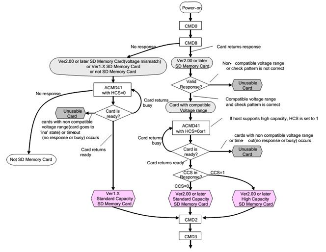

That sounds logical. However the flow chart in both the Simplified SD Host Controller Spec v2.0 and in the Physical Layer spec 5.0, for the Card Initialization and Identification flow chart, both show that if the CMD8 gets no response they then go directly to the CMD55/41.
I don't have a logic analyzer handy, but I would like to look at the actual response coming back from the card for the CMD55 right after the CMD8 to see if the card is actually sending an Illegal Command bit with the response to the CMD55 or if that is something left over in the SDMMC interface from the failed CMD8. That would clarify if it's a bug in the STM hardware or in the SD Card spec flow chart.
