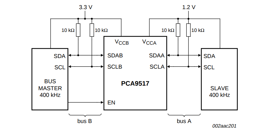

as the cpu is working at 3v3 , have the signals at 3v3 -> pullups to VDD , 3v3 . (not 5V ! )
If connecting to 5V chips and need 5V I2C signal level , use a I2C level shifter 3v3 -- 5V .
Then you are on the safe side.
shifter..standard like this :
or in a chip :
(1v2 here ---> 5v )
