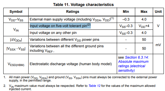

I'm a bit confused, as I believed 5V tolerant pins did not have the same protection structure, allowing the voltage to go up to 5V.
For example, on the STM32F407 you're allowed to apply a voltage up to VDD + 4V:

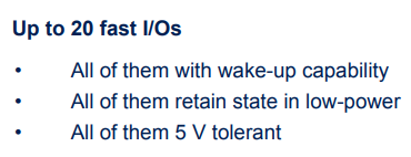

The STM32WB datasheet doesn't seem to specifically mention the FT pin characteristics, besides stating:
In what situations would the STM32WB05 5V tolerant pins actually be 5V tolerant in that case?
When initialised as input, the PA and PB ports are indeed 5V tolerant - if the internal pull resistors are deactivated. I assume that this will still be corrected in the data sheet.
