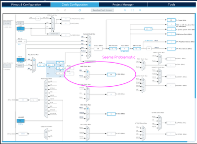

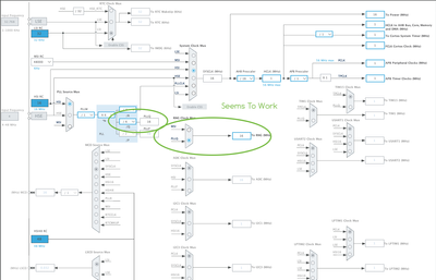

I found what seems like a smoking gun.
My system uses RNG, which - by default - is clocked by MSI. I notice that when I disable RNG, this odd behavior goes away completely. When I configure the RNG to be clocked by PLLQ instead of MSI, this also seems to get rid of the problematic behavior.
I'm attaching files exemplifying these three scenarios here.
I am still trying to understand what I might be missing in the MSI case that causes this sporadic hanging, and whether there's a way to solve this (mostly because I am interested in learning - it makes me feel a little itchy to just switch to PLLQ without clearly understanding why that works and the MSI case does not).
