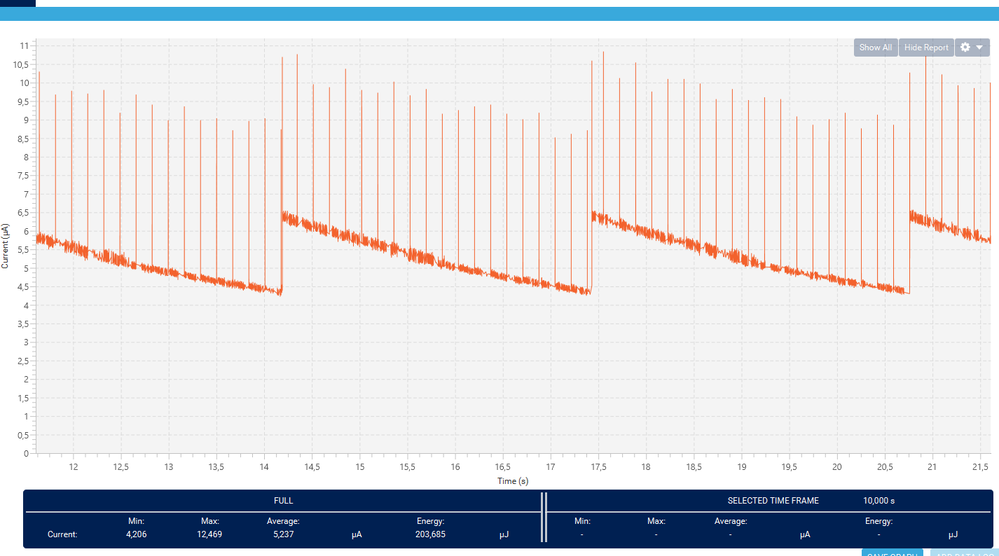

Even with a minimal firmware that goes straight to STOP1 and (supposedly) nothing enabled, I measure ~5–6 µA average at room temp. The current trace shows a baseline of ~4.2–5 µA with short spikes to ~10–12 µA every ~100 ms. That really looks like something waking up periodically.
What I see on the analyzer (≈3 V supply):
Baseline settles around 4.2–5 µA
Spikes to ~10–12 µA every ~100 ms
Average ≈ 5.2 µA
If I switch to the deepest mode, I get < 0.5 µA, which makes me think the PCB is fine and I’m just missing a setting in STOP1.

}current graph showing spikes
2025-09-01 2:15 AM
Hello @leddel32;,
Check for any enabled EXTI lines configured in interrupt or event mode, they may lead to unintended wake-ups or current spikes in STOP1 mode
