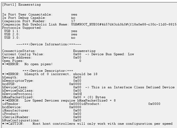

Everything else is working fine.
Setup packet with SET_ADDRESS received and processed.
Next GET_DESCRIPTOR for DEVICE which is sent back ok
I've verified the data written to the Tx FIFO is correct.
Correct number of bytes it transmitted but the bytes are not correct.
I'm using a STM32H743-EVAL board, hardware is working fine
Any suggestions?
p.s. the Device Descriptor received displayed by USB View

Hi @lw23
Would you double-check the device descriptor data you are writing to the Tx FIFO. Ensure that all fields are correctly populated according to the USB specification. The bLength field should be 18 for a standard device descriptor.
