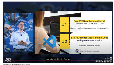

Ah - this has just appeared: New strategic directions for STM32Cube by @Maxime_MARCHETTO:
We are moving back to FreeRTOS™ as the main kernel, integrating it with USBX, FileX, and LWIP. This strategic shift will help us build a consistent middleware offering, set to be introduced before the end of this year. Notably, USBX and FileX will be available in both bare metal and RTOS-agnostic versions, providing greater flexibility and adaptability for your projects.
In parallel, we continue our investment in supporting leading open-source frameworks.

So here: https://youtu.be/ezHZGMuEA1k?t=2946
