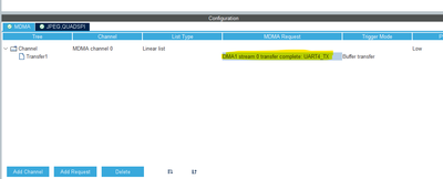

I would like to transfer 3 linked list blocks over UART DMA. When I started HAL_MDMA_START_IT, it transmits only 16 bytes. How can I send big files back to back? Configurations are as follows:
MCU : STM32H7 series
Firmware : Last release

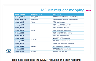

Unfortunately, you cannot not use UART with MDMA in linked list mode. There not MDMA Request for UART peripheral.
Please see the document below for more details:
STM32H7-System-Master direct memory access controller (MDMA)
In the driver also you can see that there is no MDMA request for UART.
/** @defgroup MDMA_Request_selection MDMA Request selection
* @brief MDMA_Request_selection
#define MDMA_REQUEST_DMA1_Stream0_TC ((uint32_t)0x00000000U) /*!< MDMA HW request is DMA1 Stream 0 Transfer Complete Flag */
#define MDMA_REQUEST_DMA1_Stream1_TC ((uint32_t)0x00000001U) /*!< MDMA HW request is DMA1 Stream 1 Transfer Complete Flag */
#define MDMA_REQUEST_DMA1_Stream2_TC ((uint32_t)0x00000002U) /*!< MDMA HW request is DMA1 Stream 2 Transfer Complete Flag */
#define MDMA_REQUEST_DMA1_Stream3_TC ((uint32_t)0x00000003U) /*!< MDMA HW request is DMA1 Stream 3 Transfer Complete Flag */
#define MDMA_REQUEST_DMA1_Stream4_TC ((uint32_t)0x00000004U) /*!< MDMA HW request is DMA1 Stream 4 Transfer Complete Flag */
#define MDMA_REQUEST_DMA1_Stream5_TC ((uint32_t)0x00000005U) /*!< MDMA HW request is DMA1 Stream 5 Transfer Complete Flag */
#define MDMA_REQUEST_DMA1_Stream6_TC ((uint32_t)0x00000006U) /*!< MDMA HW request is DMA1 Stream 6 Transfer Complete Flag */
#define MDMA_REQUEST_DMA1_Stream7_TC ((uint32_t)0x00000007U) /*!< MDMA HW request is DMA1 Stream 7 Transfer Complete Flag */
#define MDMA_REQUEST_DMA2_Stream0_TC ((uint32_t)0x00000008U) /*!< MDMA HW request is DMA2 Stream 0 Transfer Complete Flag */
#define MDMA_REQUEST_DMA2_Stream1_TC ((uint32_t)0x00000009U) /*!< MDMA HW request is DMA2 Stream 1 Transfer Complete Flag */
#define MDMA_REQUEST_DMA2_Stream2_TC ((uint32_t)0x0000000AU) /*!< MDMA HW request is DMA2 Stream 2 Transfer Complete Flag */
#define MDMA_REQUEST_DMA2_Stream3_TC ((uint32_t)0x0000000BU) /*!< MDMA HW request is DMA2 Stream 3 Transfer Complete Flag */
#define MDMA_REQUEST_DMA2_Stream4_TC ((uint32_t)0x0000000CU) /*!< MDMA HW request is DMA2 Stream 4 Transfer Complete Flag */
#define MDMA_REQUEST_DMA2_Stream5_TC ((uint32_t)0x0000000DU) /*!< MDMA HW request is DMA2 Stream 5 Transfer Complete Flag */
#define MDMA_REQUEST_DMA2_Stream6_TC ((uint32_t)0x0000000EU) /*!< MDMA HW request is DMA2 Stream 6 Transfer Complete Flag */
#define MDMA_REQUEST_DMA2_Stream7_TC ((uint32_t)0x0000000FU) /*!< MDMA HW request is DMA2 Stream 7 Transfer Complete Flag */
#if defined (LTDC)
#define MDMA_REQUEST_LTDC_LINE_IT ((uint32_t)0x00000010U) /*!< MDMA HW request is LTDC Line interrupt Flag */
#endif /* LTDC */
#if defined (JPEG)
#define MDMA_REQUEST_JPEG_INFIFO_TH ((uint32_t)0x00000011U) /*!< MDMA HW request is JPEG Input FIFO threshold Flag */
#define MDMA_REQUEST_JPEG_INFIFO_NF ((uint32_t)0x00000012U) /*!< MDMA HW request is JPEG Input FIFO not full Flag */
#define MDMA_REQUEST_JPEG_OUTFIFO_TH ((uint32_t)0x00000013U) /*!< MDMA HW request is JPEG Output FIFO threshold Flag */
#define MDMA_REQUEST_JPEG_OUTFIFO_NE ((uint32_t)0x00000014U) /*!< MDMA HW request is JPEG Output FIFO not empty Flag */
#define MDMA_REQUEST_JPEG_END_CONVERSION ((uint32_t)0x00000015U) /*!< MDMA HW request is JPEG End of conversion Flag */
#endif /* JPEG */
#if defined (OCTOSPI1)
#define MDMA_REQUEST_OCTOSPI1_FIFO_TH ((uint32_t)0x00000016U) /*!< MDMA HW request is OCTOSPI1 FIFO threshold Flag */
#define MDMA_REQUEST_OCTOSPI1_TC ((uint32_t)0x00000017U) /*!< MDMA HW request is OCTOSPI1 Transfer complete Flag */
#endif /* OCTOSPI1 */
#if defined (QUADSPI)
#define MDMA_REQUEST_QUADSPI_FIFO_TH ((uint32_t)0x00000016U) /*!< MDMA HW request is QSPI FIFO threshold Flag */
#define MDMA_REQUEST_QUADSPI_TC ((uint32_t)0x00000017U) /*!< MDMA HW request is QSPI Transfer complete Flag */
#endif /* QUADSPI */
#define MDMA_REQUEST_DMA2D_CLUT_TC ((uint32_t)0x00000018U) /*!< MDMA HW request is DMA2D CLUT Transfer Complete Flag */
#define MDMA_REQUEST_DMA2D_TC ((uint32_t)0x00000019U) /*!< MDMA HW request is DMA2D Transfer Complete Flag */
#define MDMA_REQUEST_DMA2D_TW ((uint32_t)0x0000001AU) /*!< MDMA HW request is DMA2D Transfer Watermark Flag */
#if defined (DSI)
#define MDMA_REQUEST_DSI_TEARING_EFFECT ((uint32_t)0x0000001BU) /*!< MDMA HW request is DSI Tearing Effect Flag */
#define MDMA_REQUEST_DSI_END_REFRESH ((uint32_t)0x0000001CU) /*!< MDMA HW request is DSI End of refresh Flag */
#endif /* DSI */
#define MDMA_REQUEST_SDMMC1_END_DATA ((uint32_t)0x0000001DU) /*!< MDMA HW request is SDMMC1 End of Data Flag */
#define MDMA_REQUEST_SDMMC1_DMA_ENDBUFFER ((uint32_t)0x0000001EU) /*!< MDMA HW request is SDMMC1 Internal DMA buffer End Flag */
#define MDMA_REQUEST_SDMMC1_COMMAND_END ((uint32_t)0x0000001FU) /*!< MDMA HW request is SDMMC1 Command End Flag */
#if defined (OCTOSPI2)
#define MDMA_REQUEST_OCTOSPI2_FIFO_TH ((uint32_t)0x00000020U) /*!< MDMA HW request is OCTOSPI2 FIFO threshold Flag */
#define MDMA_REQUEST_OCTOSPI2_TC ((uint32_t)0x00000021U) /*!< MDMA HW request is OCTOSPI2 Transfer complete Flag */
#endif /* OCTOSPI2 */
#define MDMA_REQUEST_SW ((uint32_t)0x40000000U) /*!< MDMA SW request */

1- If it does not support, why it sends some bytes when I start mdma interrupt?
if (HAL_MDMA_Start_IT(&hmdma_mdma_channel0_sw_0, (uint32_t)tx_1, (uint32_t)&huart4.Instance->TDR, 32, 1) != HAL_OK)2-I uploaded an image about how I configured UART4 dma request. According to request mapping, I am supposed to able to connect dma 1 stream 0 to mdma list. If so, how can I do it?

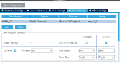

Hello @farukisiker
DMA1 should be first configured to transfer data from the USART peripheral to a buffer in memory. Once the DMA transfer is complete, MDMA is hardware-triggered to take over. MDMA then moves the data from the DMA-accessible buffer to another memory region.
2025-09-30 11:40 PM
As I understand, this is for receiving mode. What about transmitting big data over UART?
