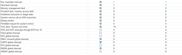

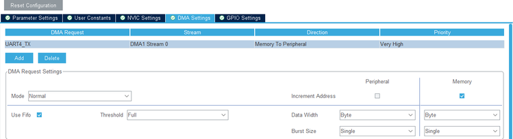

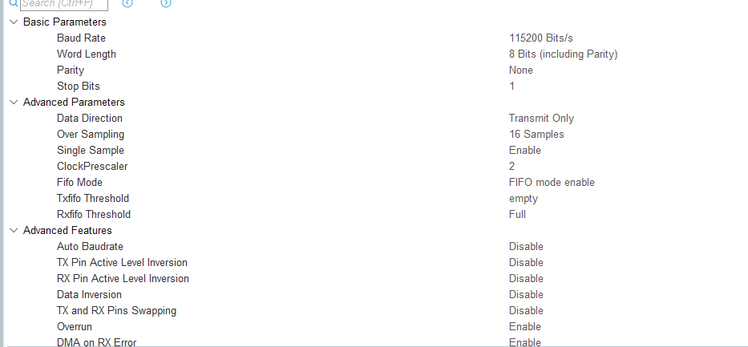

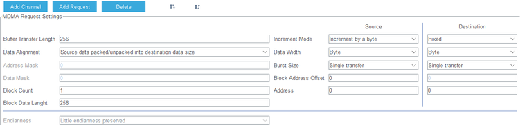

I would like to transfer 3 linked list blocks over UART DMA. When I started HAL_MDMA_START_IT, it transmits only 16 bytes. How can I send big files back to back? Configurations are as follows:
MCU : STM32H7 series
Firmware : Last release

To configure your linked list transfer, please refer to the section How to use this driver in the stm32h7xx_hal_mdma.c
##### How to use this driver #####
(#) Enable and configure the peripheral to be connected to the MDMA Channel
(except for internal SRAM/FLASH memories: no initialization is
necessary) please refer to Reference manual for connection between peripherals
and MDMA requests.
For a given Channel use HAL_MDMA_Init function to program the required configuration through the following parameters:
transfer request , channel priority, data endianness, Source increment, destination increment ,
source data size, destination data size, data alignment, source Burst, destination Burst ,
buffer Transfer Length, Transfer Trigger Mode (buffer transfer, block transfer, repeated block transfer
or full transfer) source and destination block address offset, mask address and data.
If using the MDMA in linked list mode then use function HAL_MDMA_LinkedList_CreateNode to fill a transfer node.
Note that parameters given to the function HAL_MDMA_Init corresponds always to the node zero.
Use function HAL_MDMA_LinkedList_AddNode to connect the created node to the linked list at a given position.
User can make a linked list circular using function HAL_MDMA_LinkedList_EnableCircularMode , this function will automatically connect the
last node of the list to the first one in order to make the list circular.
In this case the linked list will loop on node 1 : first node connected after the initial transfer defined by the HAL_MDMA_Init
-@- The initial transfer itself (node 0 corresponding to the Init).
User can disable the circular mode using function HAL_MDMA_LinkedList_DisableCircularMode, this function will then remove
the connection between last node and first one.
Function HAL_MDMA_LinkedList_RemoveNode can be used to remove (disconnect) a node from the transfer linked list.
When a linked list is circular (last node connected to first one), if removing node1 (node where the linked list loops),
the linked list remains circular and node 2 becomes the first one.
Note that if the linked list is made circular the transfer will loop infinitely (or until aborted by the user).
(+) User can select the transfer trigger mode (parameter TransferTriggerMode) to define the amount of data to be
transfer upon a request :
(++) MDMA_BUFFER_TRANSFER : each request triggers a transfer of BufferTransferLength data
with BufferTransferLength defined within the HAL_MDMA_Init.
(++) MDMA_BLOCK_TRANSFER : each request triggers a transfer of a block
with block size defined within the function HAL_MDMA_Start/HAL_MDMA_Start_IT
or within the current linked list node parameters.
(++) MDMA_REPEAT_BLOCK_TRANSFER : each request triggers a transfer of a number of blocks
with block size and number of blocks defined within the function HAL_MDMA_Start/HAL_MDMA_Start_IT
(++) MDMA_FULL_TRANSFER : each request triggers a full transfer
all blocks and all nodes(if a linked list has been created using HAL_MDMA_LinkedList_CreateNode \ HAL_MDMA_LinkedList_AddNode).
