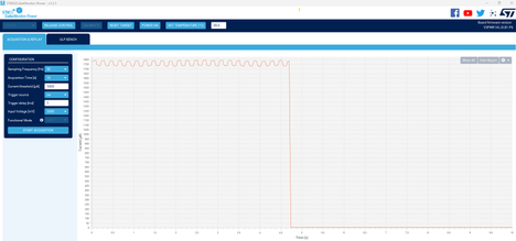

On my side I tested the PWR_STANDBY example and I found that the standby current consumption is 0.6µA
Also, I used STLINK-V3PWR and I found the same results

I was able to achieve a similar standby current to the user manual by following your method.
