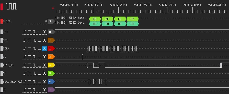

Basing on the lastest "STM32F4xx_StdPeriph_Driver" to Read SPI data and then write into external FSMC(8bit) device in the PWM interrupt like following .
void TIM2_IRQHandler(void)
SPI1->DR = 0; // SPI_InitStructure.SPI_DataSize = SPI_DataSize_16b;
FTadd = Word_Upload++; // #define FTadd (*( uint16_t *)0x64000002)
TIM_ClearITPendingBit(TIM2,TIM_IT_Update);
But from the LA waveform below, both SPI clock and FSMC #WR ops doubled.FSMC init as following

This is probably the interrupt being executed twice, due to late flag clear.

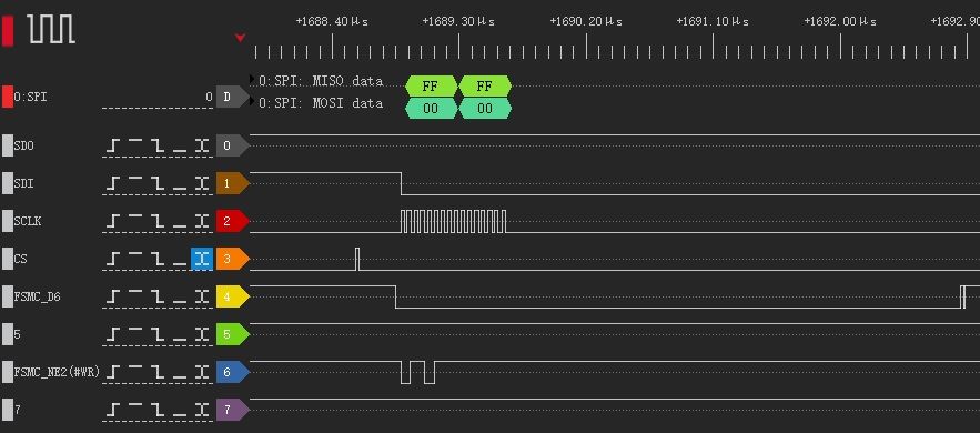

Thank you, JW. You SHORT words exactly shot it. When doing the following change, the problem is gone.
Got the following form.thanks again and like this community!!! :D
