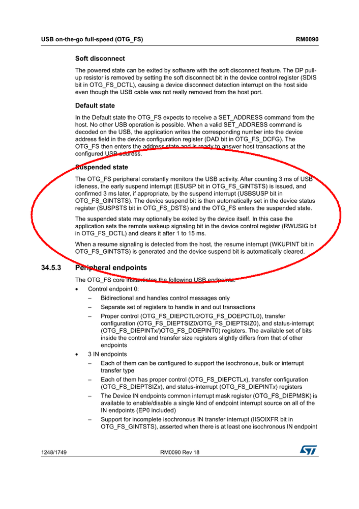

2021-01-08 11:19 AM
2021-01-08 11:28 AM
2021-01-08 11:28 AM
This seems to be talking about OTG devices, but I'm just a regular FS usb device

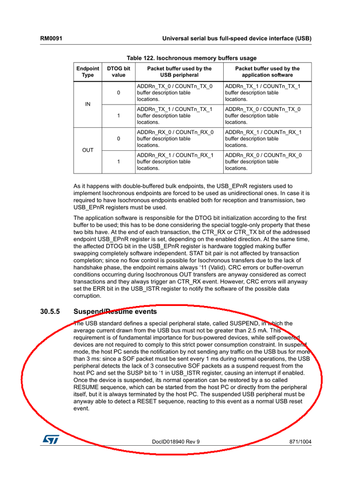

2021-01-08 4:35 PM
You did not care to tell us which STM32 are you using, and my crystal cube told me the wrong one. So one more guess:
2021-01-08 4:58 PM
Thanks for the reply, The device is an stm32L151C8T6A
I'm doing the following check continuously in the main loop
if(USB_ISTR & USB_ISTR_SUSP){The bit seems always to be 1. Is there something else I need to enable to make this work?
