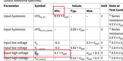

Indeed, based on TLE9879 datasheet, VIH min = 0.7*VDDP = 0.7*5V = 3.5V > VDD MCU:
So the levels of STM32 output high level is not seen as high level from TLE9879.

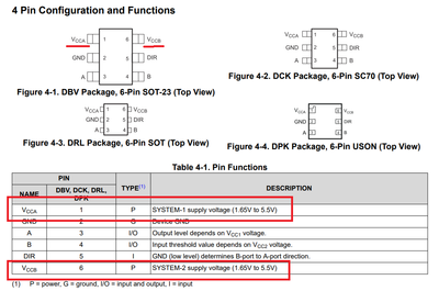

I can also suggest 74LVC1T45:
