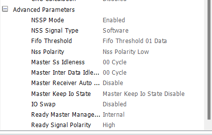

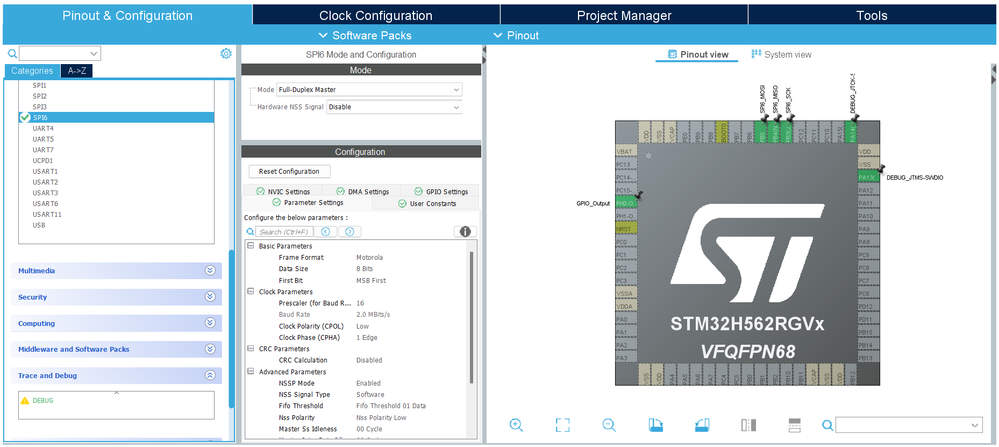

Here are my SPI6 configuration settings of my project, I changed the prescalar to different values but nothing is working. When I measure voltage on SPC and MOSI pins its giving 1.35V (If this would be an issue)

I can't see neither your GPIO configuration nor the clock system setting. Are you sure your external clock source is disabled? I don't understand what does it mean CS->PH0 and how it is related to SPI as PH0 pin should not be dependent on any SPI configuration. Note if enabled, an additional function always prevails any alternate one.
It would be helpful to double check GPIO configuration registers of the problematic pin and RCC_CR especially.
Your SPI configuration includes few contradictions evidently at least, too. You have enabled SS pulse mode which uses HW output by default while its control is set to SW mode. Anyway, to force interleaving pulses between the data frames you need to set data interleaving > 1. Applied setting it to zero makes no sense.
