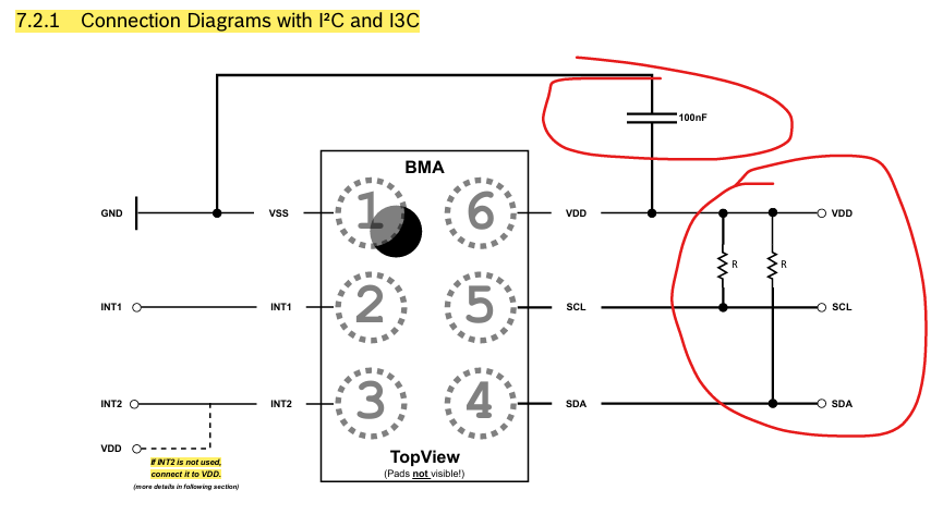

In the BMA530 Datasheet at the Connection Diagram there are two resistors which i don´t have at my board. Could the resistors be the troublemaker?

I2C always needs pull-up resistors. For slow speeds maybe the MCU's internal resistors might be good enough, but you must activate these when setting up the I2C GPIOs.
Next step: get an oscilloscope and check what's happening on the SDA & SCL lines.

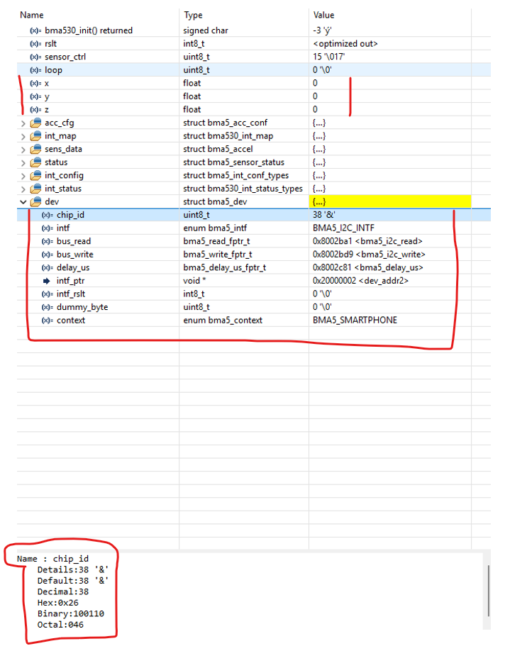

The I2C Speed Frequenzy is 100kHz and the I2C Speed Mode is in Standard Mode. I changed the GPIO Pull-up/Pull-down to Pull-up in the STM32CubeMX and generate the code. I don´t have a Oscilloscope for testing here and it´s impossible to connect the wire because the componets are placed on a thin flex PCB.

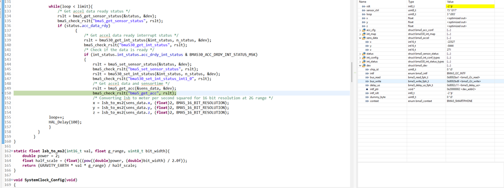

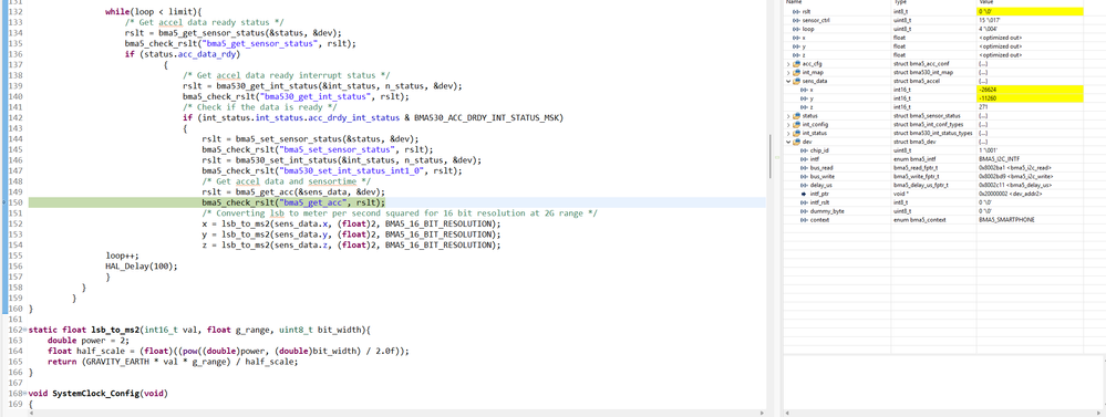

I try 2 tests in the debugg session. The first with the dev_addr2 = (0x18 << 1) and Mem_addr = 0x19.
The sens_data values for x and y changed for every loop and the value for z doesn´t changed, the sensor is layed flat on the surface so normaly the value should be for sens_data_z -16350 lsb which is -9.81m/s^2.
The question is, are the sens_data_values random and not true and are they influenced by the missed resistors?
The second test in the debugg session is with dev_addr2 = 0x18 and Mem_addr = 0x19.
There the sen_data values doesn´t changed for every loop so i think the dev_addr2 = 0x18 is not the correct one.
This will almost certainly not work. The internal pull-ups are too weak, by about an order of magnitude.
The I2C bus basically forms a "wired OR", the pull-ups are essential for the physical level. About 2k...10k should be fine. I would suggest 2.4k .. 4.7k.
It doesn't matter where you place these resistors on the bus. If your MCU sits on a board, perhaps it has connectors where you could add them to.
> I don´t have a Oscilloscope for testing here ...
I would recommend to check the datasheet of the BMA530 sensor. Probably it has an internal register that returns a fixed value upon read (often called "WHO_AM_I").
Reading that register correctly would verify that your I2C code basically works.
However, a scope or logic analyser is highly recommended.

2026-05-06 11:56 PM
i bought a breadboard and put the two 4.7kOhm resistors as mention in the bma530 Datasheet between the SDA line and V+ line and SCL Line and V+ Line.
It worked out and i can see the correct accelerometer data.
