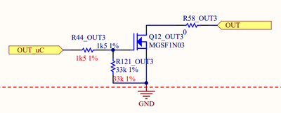

Could it be an issue on the MOSFET that actually drives the OUT and not the microcontroller output itself?
I'm currently attached to OUT, and not OUT_uC, and I'm unable to have a probe at the OUT_uC

2025-09-09 2:17 AM - edited 2025-09-09 2:18 AM
Is there a pullup resisitor at the WS2812 input? The transisitor output is effectively open drain, so you need to enforce logic high state somehow.

I'm connecting directly the OUT in the scheme to the data line of the WS2812. The WS2812 has two other lines, 5V and GND, which are connected to +5V 0V.
2025-09-09 3:58 AM
@nico23 So you definitely need a pull-up resistor of 1k5 to 4k7 between the WS2812 input and +5V. Another important thing: your PWM duty data array should probably end with an entry of duty 0, at least if you don't disable timer output.
