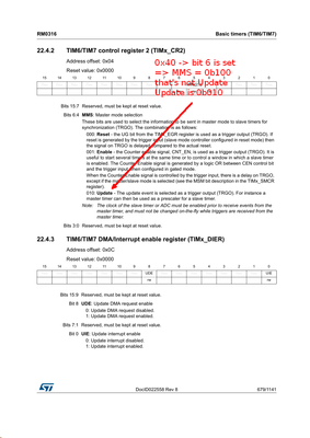

2026-01-31 7:00 AM - edited 2026-01-31 7:05 AM
TIM6->CR2 = 0x00000040
