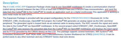

Check the oscilloscope example X-CUBE-H7DC-APP, it is using OpenAMP. Most probably CM4 is converting an external analog signal and it is sending the samples (using OpenAMP) to CM7 to display it and apply the FFT.
EDIT:
Indeed, it does (from the data brief:(
2025-09-09 4:32 AM - edited 2025-09-09 4:37 AM
EDIT:
