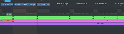

Hi @waclawek.jan and thanks for answering.
Expected waveform has a bunch of 1 and 0 encoding the LEDs colours for istance
Instead the one I previously upload has only zeros.
System clock is 48Mhz (HAL_RCC_GetSysClockFreq and HAL_RCC_GetPCLK1Freq both return 48M) so the period for each beat should be around 1,25us
but instead I'm seeing different periods. Below a working PWM generated by DMA
WHat do you mean with Try longer times, or higher system clock frequency. ?
