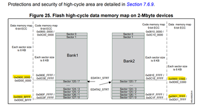

2025-10-03 2:19 AM
Hello @PFlor.2
The EDATA area did not start at 0x08020000. Please see in the screenshot below the address start of EDAT area in BANK1 and BAK2 from reference manual.
2025-10-03 8:12 AM
I guess I did not fully understand the implementation of FLASH_TYPEPROGRAM_WORD_EDATA type. I see now that the HAL_FLASH_Program() checks for the EDATA area in order to use this program type.
There doesn't seem to be another type FLASH_TYPEPROGRAM_WORD allowed in H5 series, so that is why I thought the FLASH_TYPEPROGRAM_WORD_EDATA could be used for writing word size data. Thanks for the clarification, I believe I've been able to use the FLASH_TYPEPROGRAM_QUADWORD type to write the application program to the correct area of flash from the bootloader.
Just to confirm, it seems that the FLASH_TYPEPROGRAM_QUADWORD is the only size available to write to the standard user area of the internal flash.
