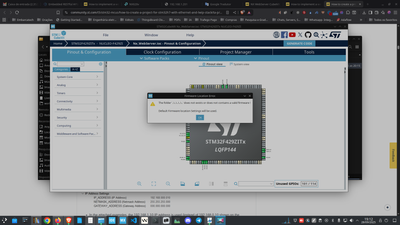

2025-09-28 3:14 PM
This error is happening when I load the project into CubeMX for the first time.

2025-10-03 11:19 AM - edited 2025-10-03 11:47 AM
Hello, thank you for your attention.
I've already tried removing and creating the project, but I always get this error. I'll try removing the firmware and reinstalling it. I'll also try removing everything and reinstalling everything. I use Linux and have never had similar problems. Strangely, the compilation works, but the code seems empty in terms of the example's purpose.
I'll get back to you later today.
