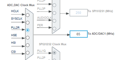

}IOC file selects PLL2R for 65 MHz ADC clock...

Another observation: HAL_RCCEx_GetPeriphCLKFreq(RCC_PERIPHCLK_ADC) returns 250 MHz, not 65 MHz as I expected. Still doesn't explain why I measure 3.9 ms for average conversion.

if the ADC is indeed running at 250MHz :
Could you please share your RCC/ADC clock config?

}To corelate ADC conversion rate with a thread period I changed ADC prescalar divisor from 1 to 2, and decreased oversampling from 256x to 64x. Other ADC parameters unchanged.
I suspect HAL_RCCEx_GetPeriphCLKFreq(RCC_PERIPHCLK_ADC) is not returning ADC clock correctly because:
With ADC prescalar divisor at 1, the ADC counts I read are not accurate. With ADC prescalar divisor at 2 or more, the ADC counts I read are as expected.

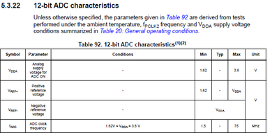

Could I be overclocking the ADC?
