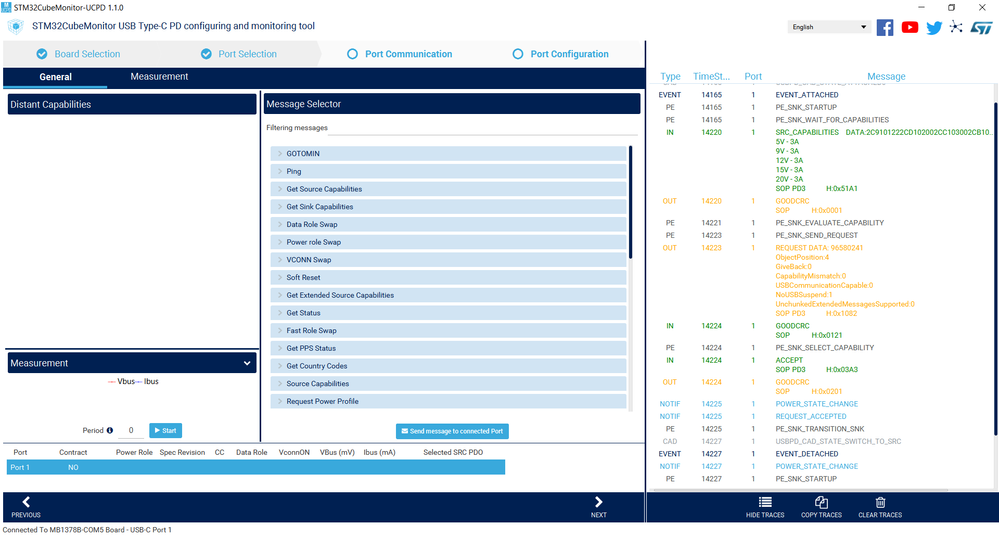

I am able to get 15V across VBUS after I connect my Disco board to Source device, but the ADC reading value is 16125mV. I found ADC reading Error while reading High voltages(i.e. greater than 10V).
please have a look at the fallowing USBPD log:
After some period of time(typically 10S) PD is Resetting automatically. I suspect that is because of ADC Error only, please suggest some changes to us so that we can get better accuracy.

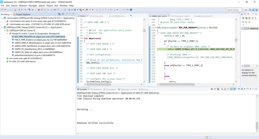

Note : after 10 seconds BSP_PWR_VBUSOff() automatically getting called.

In the attached screenshot you put, I don't have a success of the negociation. SRC did not sent a PS_RDY, there is a detach before.
Question: did you change the content of the function 'USBPD_PWR_IF_SetProfile'. Do you set correctly the VBUS value? The code I have is the default the 1st PDO set to 5V.
Note: instead of doing a copy of our cubeMX, you can deliver a file automatically saved on your laptop (.cpd file) under c:\Users\your_login\AppData\Local\Temp\STM32CubeMonitor-UCPD\Acquisition\. (https://wiki.st.com/stm32mcu/wiki/USB_Power_Delivery_overview#Specific_tools)

Even after this setting USBPD control getting to BSP_PWR_VBUSOff() each time after Power profile setting.

still the SRC did not sent a PS_RDY, there is a detach before.

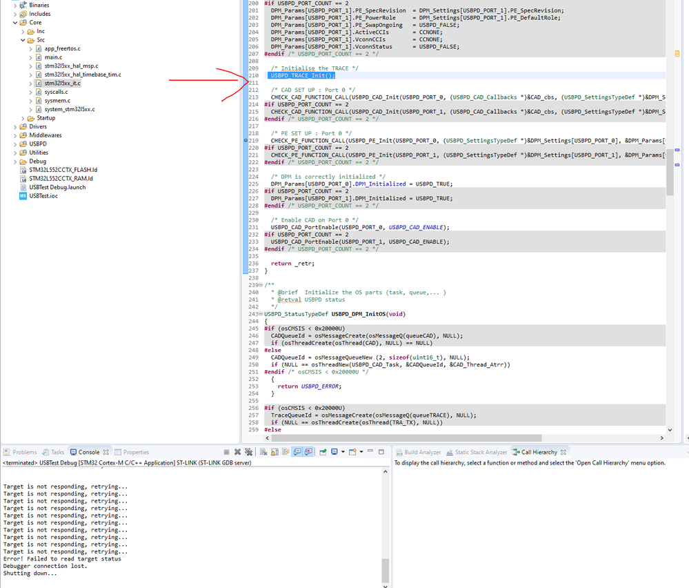

im trying hard to run the USB PD feature on the STM32L552CCT6 controller.
So i rebuild the USB-PD_Consumer_1port example for the STM32L5 to my controller.
All is the same, but when im trying to start and debug the program, the controller stucks after the initalization.
I figured out that the last called function is the USBPD_TRACE_Init(); in the usbpd_dpm_core.c file.
After that the debugger lost the connection to the target and the program stucks. I have to erase the full chip to get the connection again.
I have really no idea whats going on.
So my question is: Does anybody have an idea where the problem is?
Thanks!
